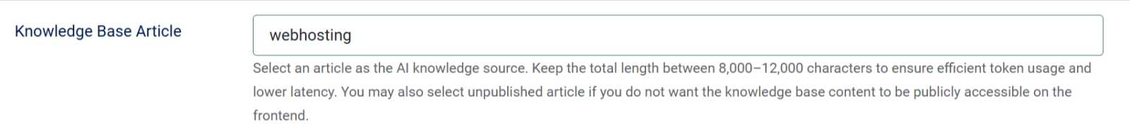

Hi. I am not able to select any knowledgebase article. Nothing happens on input on Joomla 5. Also you explain that there can be articles selected. Is it possible to load several articles as knowledge base?
Looks like the field type is wrong in config.xml
Should be modal_article but then only one article is selectable. And from your code AIHelper.php you only want to load a single article

Hi Gee,
the article selection will appear after you start typing something in the input field and when there is a matching article available.
Please refer to this video : www.dropbox.com/scl/fi/8ymxmf82ff2ou1u4e...mh&st=3wipmezw&raw=1
For that reason, I thought it would be more efficient and reliable to limit it to a single article. In practice, if multiple pieces of information are needed, they can simply be combined into one article without any issue.

Wait, I think I’ve identified the issue with the article picker. Please stay tuned
10 months 3 weeks ago #3
Hi Gee, done, I’ve fixed the issue with the article picker. Please re-download/re-install the updated version (v1.0.1)

Thank you. The selection now works. But I bought this to combine multiple articles as a knowledge base as presented. There is a description to warn users to now use too many articles and you even count the chars. So I'd be thankful if you would add a multiple option.
